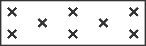

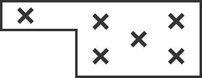

To maintain high accuracy throughout the processed outputs, Esri recommends using additional points for large or oddly shaped sites, or sites with many elevation changes.
For sites larger than 20 acres (eight hectares, or 80,937 m2), Esri recommends adding one GCP for each subsequent 15 acres (six hectares, or 60,702 m2).

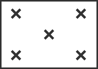

To set the first five points, visualize the five face of a dice, as shown in the next image. One point near each corner, but not on the very edge of the mapped area, and one near the center. Distribute other points evenly between the first five.
Sample GCP layouts

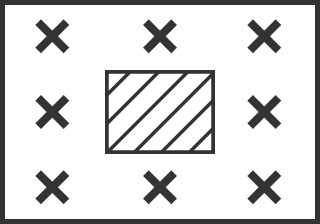

Active construction sites may have difficulty laying a control point near the center of the site, and it is acceptable to omit this point if unpractical. Esri recommends adding at least two additional points along the perimeter.

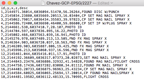

  • Surveyors typically deliver a *.txt or *.csv file containing the CRS and units or EPSG code, and XYZ data for each point, along with a description.
  • Assign the same CRS to your Site Scan for ArcGIS Manager project.
