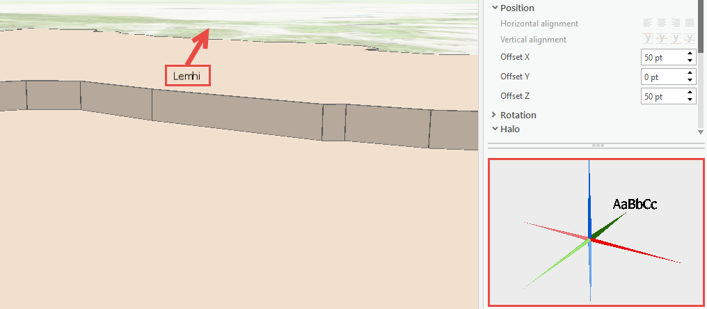

In ArcGIS Pro, attempts to change the positions of the 3D feature labels in a scene by modifying the offset values in the Label Class pane result in no change. This issue is represented in the image below. Although the label preview displays the new position when the values of Offset X, Offset Y and Offset Z are changed, the changes are not displayed in the scene. The label is not positioned correctly and the red arrow indicates where the new position of the label must be displayed.
Label not positioned correctly in the scene
Cause
This is expected behaviour in ArcGIS Pro. In the Label Class pane, most labelling options are disabled. For more information, refer to BUG - 000093727.

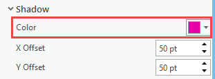

  1. Under the Shadow option, change the color of the shadow to the desired colour.
Colour of the shadow

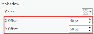

  1. Change the X offset and Y offset to the desired values according to the desired position.

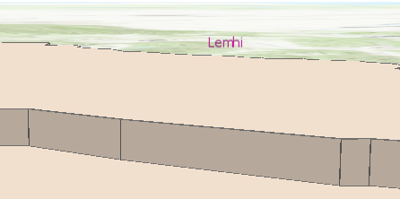

  1. Click Apply to view the changes.
The image below shows the 3D feature label positioned correctly in the scene.
New position of the 3D feature label
