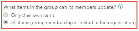

In ArcGIS Online, when creating a group, it is possible to restrict members of the group from updating items using the 'What items in the group can its members update?' option. Selecting the 'Only their own items' option creates a group without update capabilities, and the 'All items (group membership is limited to the organization)' option creates a group with update capabilities.
