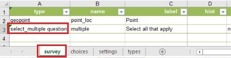

  1. In ArcGIS Survey123 Connect, open the survey XLSForm.

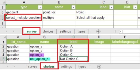

  2. In the survey worksheet, in the type column, select the cell with the Select Multiple question (select_multiple <list name>).
The Select Multiple question in the survey XLSForm.

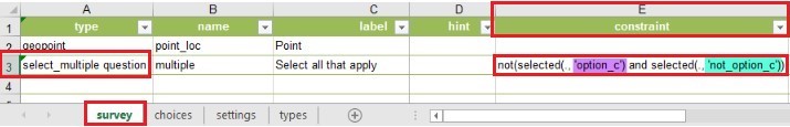

  1. Create a constraint for Option C and Not Option C. For more information on using the constraint formula, refer to ArcGIS Survey123: Formula operators.
    1. In the constraint column, select the cell that is parallel to the Select Multiple question. In the example below, select E3.
Select E3.
  1. In the selected cell, type the following script:
not(selected(., 'option_c') and selected(., 'not_option_c'))

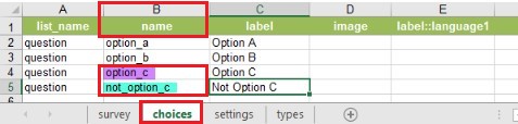

Insert the values from the choices worksheet and name column into the formula above.
The values in the name column in the choices worksheet.

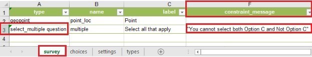

  1. Create a return constraint message when users select both Option C and Not Option C as a response.
    1. In the constraint_message column, select the cell that is parallel to the Select Multiple question. In the example below, select F3.
The Constraint message in the survey worksheet.
  1. In the selected cell, type the constraint message, as shown below.
You cannot select both Option C and Not Option C.

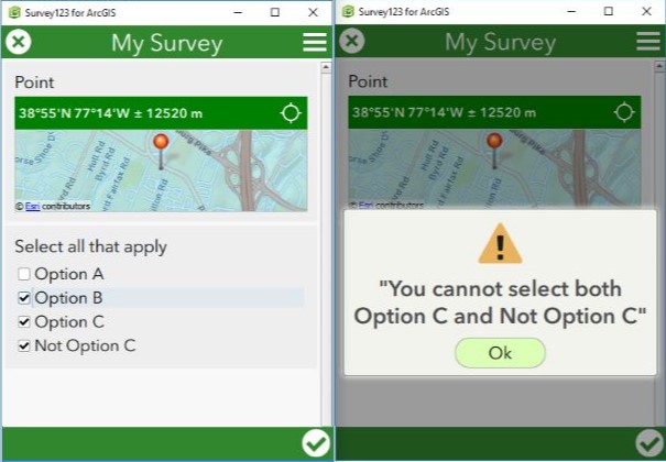

If the user selects both Option C and Not Option C, the constraint message is displayed.
The Constraint message shown when selecting Choice C and Not Choice C.
