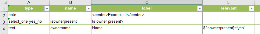

In the example below, the relevant question (ownername) is placed before the question (isownerpresent) that provides the value in the expression of the relevant question.
(ownername placed before (isownerpresent)
When the form is not submitted and later loaded for editing, any response that was previously entered in the "ownername" question is not saved as the "isownerpresent" question is processed after the relevant question. This is a known limitation, but also the expected behavior of forms.
To save the response of the relevant question, place the question that provides the value to the relevant question above the relevant question in the form order. So for this example, the "isownerpresent" question is placed above the "ownername" question.
(isownerpresent) placed before (ownername)
