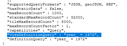

The view definition is defined at the service level, and the viewDefinitionQuery property is updated. Navigate to Portal REST API Directory > the layer ID > JSON to define and update the view. The property is displayed as shown in the image below:
Property is displayed
Note:
Changing the value of viewDefinitionQuery also updates the related definitionQuery property.

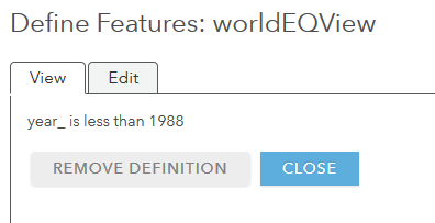

To verify, check the Set View Definition settings.
