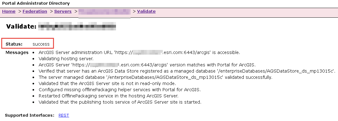

Check the validation status of the federated hosting server
  1. Sign in to Portal Administrator Directory and click Federation > Servers. Select the hosting server and click Validate. A successfully validated server shows Status: success. Refer to ArcGIS REST API: Validate Server for more information.
Image of the server validation status in Portal Administrator Directory
  1. In Portal for ArcGIS Map Viewer, test the accessibility of the Analysis tools.

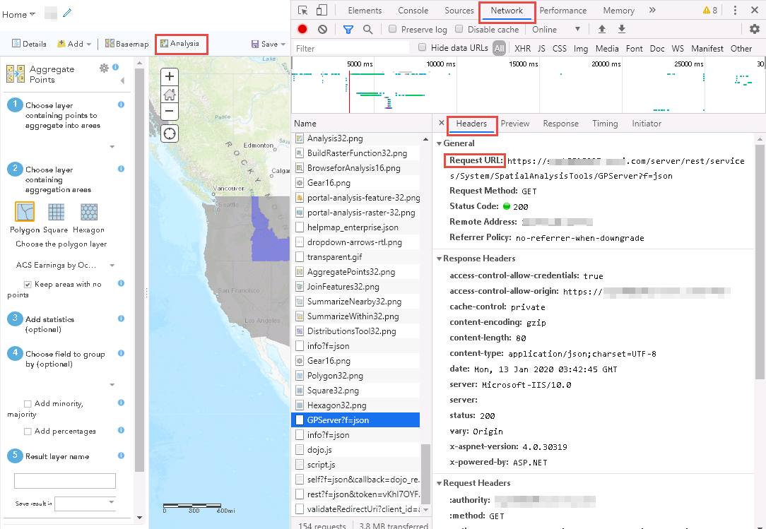

Capture the web traffic on a web browser using built-in browser developer tools
If the issue persists, use the developer console window on the web browser to capture the Network traffic in Portal for ArcGIS.
Note:
The following steps are carried out using Google Chrome Developer Tools.
  1. Open the developer console window in Google Chrome and click the Network tab.
  2. Sign in to the Portal for ArcGIS home page. In Portal for ArcGIS Map Viewer, click Analysis. In the developer console window, find the .json file in the Name section, and inspect the resource details on the Headers tab. The Request URL must be identical to the URL set when the server is federated.
Image of developer console window on Google Chrome in Portal for ArcGIS Map Viewer

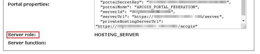

  1. If the Request URL is different, check the Hosting Server set in Portal for ArcGIS. To do so, click Organization > Settings > Servers, and take note of the server name under Hosting Server.
  2. Log in to the ArcGIS Server Administrator Directory of the hosting server identified in Step 3. Click Admin > security > config, and verify the Server role is set to HOSTING_SERVER.
Image of Server role status in ArcGIS Server Administrator Directory
  1. If the Server role in the ArcGIS Server Administrator Directory states FEDERATED_SERVER, proceed with the following:
    1. Remove the hosting server from Portal for ArcGIS.
    2. Refresh the ArcGIS Server Administrator Directory, and specify the hosting server in Portal for ArcGIS.
    3. Refresh the ArcGIS Server Administrator Directory, and ensure the Server role is updated to HOSTING_SERVER.
