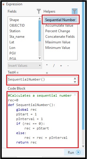

Using the Calculate Field function
Note: This option only generates sequential numbers for unsorted data based on the OBJECTID order. If the data is sorted, the generated numbers are not sequential.

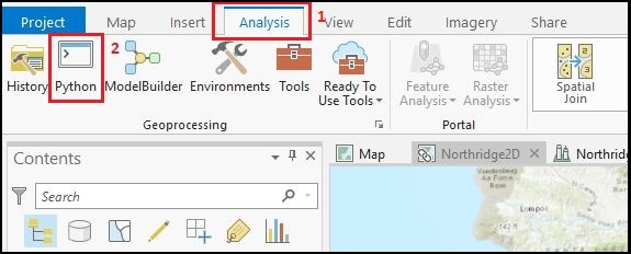

Using a Python script through the Python window
The following steps demonstrate how to create sorted sequential numbers using the autoIncrement() ArcPy function:
