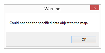

Clicking OK in the error dialog box above returns the following warning message:
Error:
Warning: Could not add the specified data object to the map.
An image of the error returned when opening the mosaic dataset.
