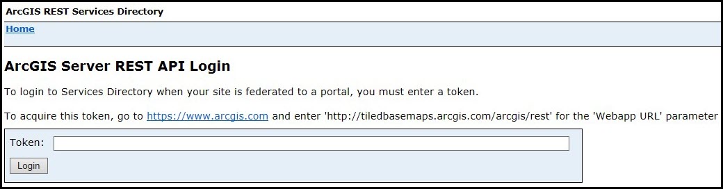

To export tiles from the World Imagery, use the instance of the World Imagery hosted on the tiledbasemaps.arcgis.com server referenced by this map service item, which has the Export Tiles operation enabled. To generate a tile package from the World Imagery service, follow the steps below.
Note: This method requires an organizational account, but does not consume credits.
https://<organization short name>.arcgis.com/sharing/generateToken?f=json&username=<username>&password=<password>&referer=http://www.arcgis.com
Note: It is best to generate the token using administrator credentials. Refer to ArcGIS REST APIs: Generate Token.
