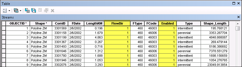

The image below is an example of coded value domain and subtype code:
Example of coded value domain and subtype code

  1. In ArcMap, navigate to Customize > ArcMap Options > Tables.
  2. Uncheck the 'Display coded value domain and subtype descriptions' option.
    Change the setting through the ArcMap Options dialog box
  3. Click OK.
  4. Close and reopen ArcMap.
Change the settings for one particular layer only
This option only affects specific layers that the setting is changed for.
  1. Right-click the layer in the Table of Contents, and select Open Attribute Table.
  2. Click Table Options in the top left corner of the attribute table.
  3. Select Appearance.
  4. In the Table Appearance dialog box, uncheck the 'Display coded value domain and subtype descriptions' option.
    Change the setting through the attribute table
  5. Click OK.
  6. Close and reopen ArcMap.
