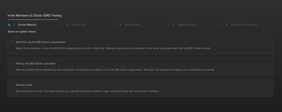

Choose Method
Choose how to invite members. Site Scan administrators can invite members in the following methods:
  • Select from a list of members in their ArcGIS Online organization (requires admin to use ArcGIS Sign In)
  • Add members by ArcGIS Online username
  • Add members by email
Note:
You must be an ArcGIS Online administrator to invite members to Site Scan from your ArcGIS Online organization. If you encounter this issue, contact your ArcGIS Online administrator and have them upgrade your User Role.
Note:
If your organization has enabled the user authentication organization setting that requires ArcGIS Sign In, you will not see this Choose Method step because all invitations must come from your ArcGIS Online organization.
Invite members - choose method

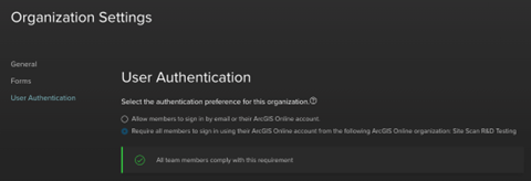

ArcGIS Online Sign In User Authentication setting
What is the User Authentication Setting?
Site Scan offers a new organization setting preference called User Authentication. The authentication preference allows admins to choose whether to restrict authentication and new user invitations based on ArcGIS Online membership. It is located under Organization Settings > User Authentication.
The first option allows members to sign in by email or by their ArcGIS Online account. This is the default and least restrictive option.
The second option requires all members to sign in using their ArcGIS Online account from your ArcGIS Online organization. Note that enabling this option will not restrict existing user access to your Site Scan organization, even if they are not compliant with the setting. Instead, it enforces a restriction on how new users can be added to your Site Scan organization.
For example, if there are members of your organization who use the email sign in method rather than by their ArcGIS Online account, these users will still be able to sign in and perform all app functions. They will be presented with a warning shown below each time they sign in notifying them that they do not comply with the organization’s user authentication requirement. These users should take action to become compliant with their Site Scan organization’s requirement. See the section, 'How to become compliant' for guidance.

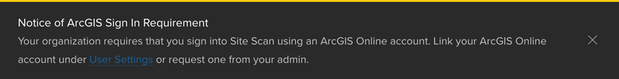

Notice of ArcGIS Sign In Requirement
However, this setting will enforce a restriction in the member invitation workflow: the only option to invite new members to Site Scan will be to add existing members of your ArcGIS Online organization. You will no longer be able to invite members by email.
When all members of your Site Scan organization comply with this setting, new and existing members of your Site Scan organization will also be members of your ArcGIS Online organization and must sign into Site Scan using their ArcGIS Online account. If your ArcGIS Online organization is configured with organization-specific login such as SAML, OAuth/Social Logins, or OpenID Connect, it will also be used to sign into Site Scan.
Read more about configuring organization-specific login in ArcGIS Online here.

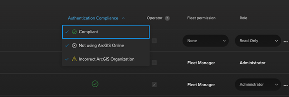

Administrator’s view of non-compliant members
When the User Authentication setting is enabled and there are non-compliant members in your Site Scan organization, administrators will immediately see who these members are in the Team Members page. Each user will show an icon indicating their compliance status:
  •   Compliant
  •   Not using ArcGIS Online
  •   Unverified Site Scan account or using ArcGIS Online sign in with a different ArcGIS Online organization
For your Site Scan organization to be compliant with the User Authentication setting, it is necessary to identify the non-compliant members and work towards a resolution. Administrators have the option to filter the Team Members page to only show non-compliant members. This allows admins to identify and follow up with members individually so they can take the necessary steps to become compliant in the Site Scan organization.
The authentication compliance status for an individual is updated each time they sign into Site Scan. New Site Scan users should sign in and verify their account so that their authentication compliance is accurate.
Authentication Compliance filter on the Team Members page

You will know that you are compliant when you no longer see the banner notice of the requirement upon logging in.
Administrators will know that everybody in their organization is compliant when they see a success message under the User Authentication setting. The Authentication Compliance column on the Team Members page will also no longer appear.
User Authentication setting - success
