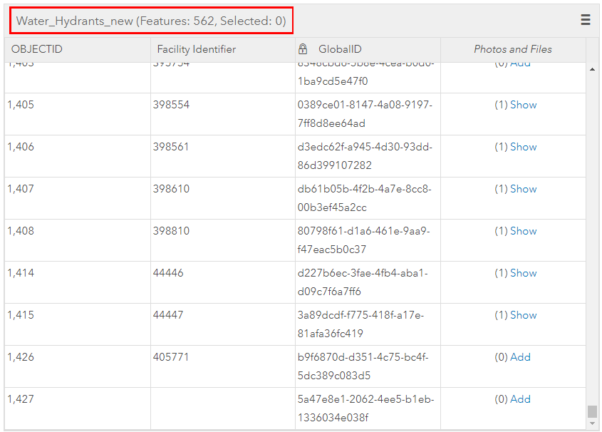

The image below is an example of attributes with attachments in a hosted feature layer that must be merged with another hosted feature layer and retain all attachments.
An image of attribute fields of a hosted feature layer containing attachments before being appended to another hosted feature layer.

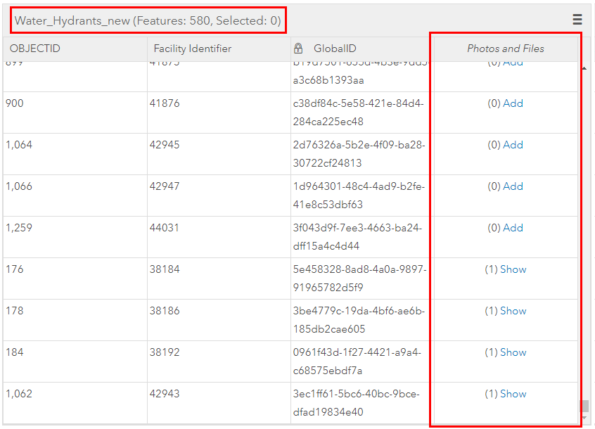

The following figure shows the attributes of the hosted feature layer that have been appended with features and attachments from another hosted feature layer.
An image displaying the attributes of the appended hosted feature layer containing the retained attachments.
