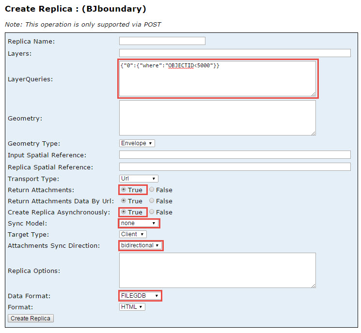

  1. Navigate to the ArcGIS REST Services Directory page of the hosted feature service, scroll to the bottom of the page, and click Create replica.
    Operation Create Replica
  2. Set the following options for the replica:
    1. Under LayerQueries:
    {"0":{"where":"OBJECTID<=5000"}}
    Note:
    This creates a replica with the first 5000 Object IDs from LayerID 0. The value of OBJECTID may vary depending on the user's data.
  1. Return Attachments: True
  2. Create Replica Asynchronously: True
  3. Sync Model: None
  4. Attachments Sync Direction: bidirectional
  5. Data Format: FILEGDB.
Create Replica

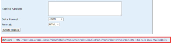

  1. Keep the rest of the settings to default and, click Create Replica. A 'statusURL' displays at the bottom of the screen. Click the URL.

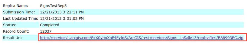

  1. Click the Result URL to download the zip file.
User-added image
Note:
Repeat the process for all the subsequent records, only, the OBJECTID keeps changing. For example, the following query creates a replica with the Object ID from 5001 to 10,000.
{"0":{"where":"OBJECTID>5000 AND OBJECTID<=10000"}}
ObjectID fields are sequential and start with the number 1 for geodatabase data. If there is any discrepancy in the hosted feature service data, the number of features downloaded may be less than the number of Object IDs set in the query. For example, if there is no feature with the Object ID 1000 in the feature service, the total feature downloaded is 4999 instead of 5000.
