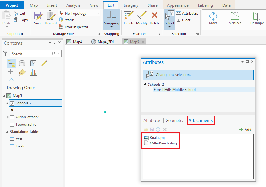

The exported feature class is stored in the file geodatabase specified in Step 6, containing the feature attachments. Refer to the following document for steps to view or open the feature attachments in ArcGIS Pro: Open an attached file. The figure below is an example of the exported feature containing the attachments.
User-added image
