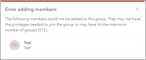

In ArcGIS Online, when attempting to add a member in an organization to a group, the following error message is returned:
Error:
Error adding members.
The following members could not be added to this group. They may not have the privileges needed to join the group or may have hit the maximum number of groups (512).
Image of the error message

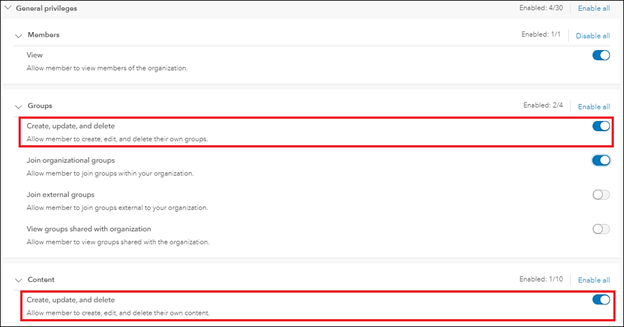

Update the member’s role to enable the privilege to join a shared update group
Note:
The member remains in the group after reverting to the originally assigned role (Viewer or Data Editor).

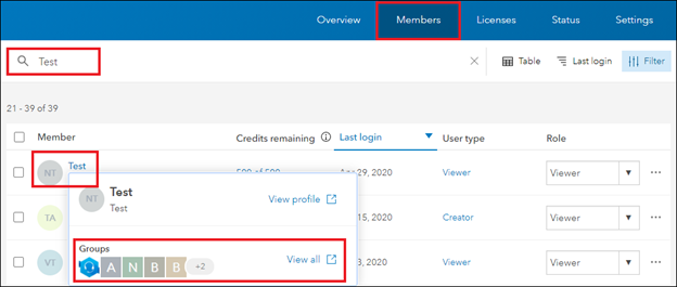

Remove the member from an existing group to join a new group
  1. Sign in to ArcGIS Online, and click Organization > Members.
  2. In the search panel, type the member’s name.
  3. In the member list, click the member’s name.
  4. In the member’s profile pop-up, under Groups, click View all.
Image of the Members tab
