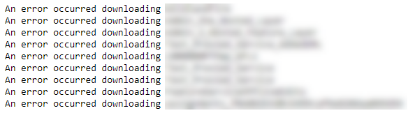

def download_as_fgdb(item_list, backup_location): for item in item_list: try: if 'View Service' in item.typeKeywords: print(item.title + " is view, not downloading") else: print("Downloading " + item.title) version = dt.datetime.now().strftime("%d_%b_%Y") result = item.export(item.title + "_" + version, "File Geodatabase") result.download(save_path=backup_location) result.delete() print("Successfully downloaded " + item.title) except: print("An error occurred downloading " + item.title) print("The function has completed") download_as_fgdb(items, folder_path)
