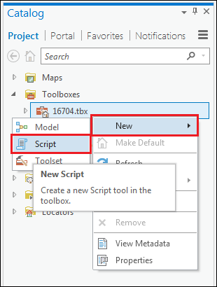

  1. In ArcGIS Pro, right-click a toolbox in the Catalog pane, and click New > Script
The steps to create a new script tool in the Catalog pane

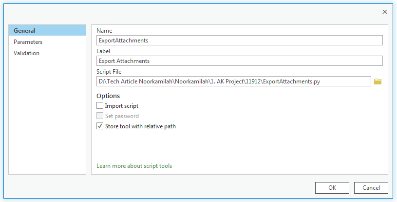

  1. In the New Script window, set the properties of the script tool as follows:
    1. On the General tab, type the Name and Label for the script tool. For example, type ExportAttachments as the Name, and Export Attachments as the Label. The label displays the name of the script tool, as shown in the Geoprocessing pane.
    2. Check the Store tool with relative path check box.

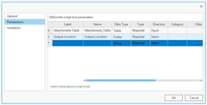

    3. On the Parameters tab, type Attachments Table in the first row of the Label column, and set the Data Type as Table. This is the first parameter of the script tool and it defines the table containing the attachments to export.
    4. In the second row, add a second parameter with the Label name as Output Location, and set the Data Type as Folder. This parameter defines the folder to locate the exported attachments.
Configure the properties for the new script tool.
  1. On the Execution tab, click the Browse icon The Browse icon next to the Script File field, and navigate to the location of the script file saved in Step 1. Select the script and click OK.

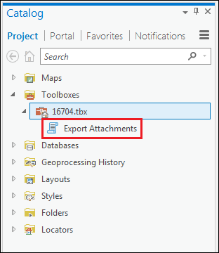

  2. Click OK. A new script tool is added to the toolbox.
The created Export Attachments script tool.

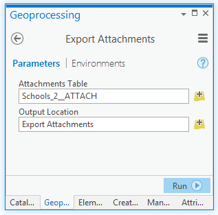

  1. Double-click to open the created script tool. Set the parameters of the tool as follows to export the attachments in a batch.
    1. In the tool dialog box, browse for the attachments table containing the attachments to export in the Attachments Table parameter.
    2. In the Output Location parameter, select a folder to save the exported attachments, and click OK.
    3. Click Run.
The Export Attachments tool dialog box.

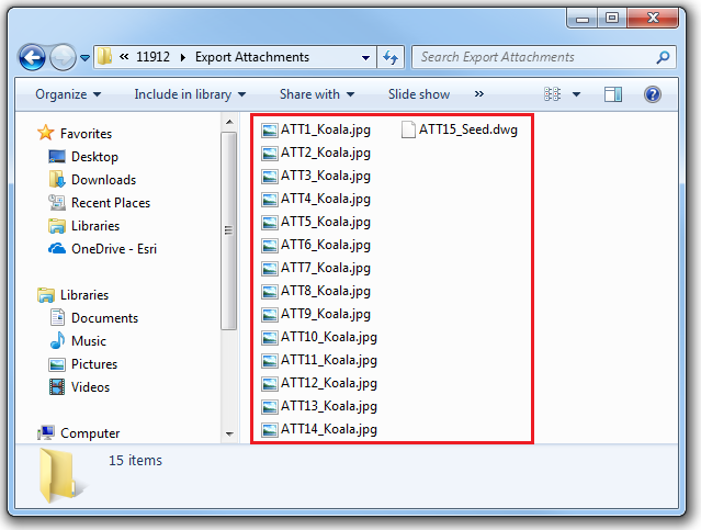

The attachments are successfully exported in a batch, and located in the folder defined in the Output Location parameter.
A list of the exported attachments in the location of the Output Location parameter
