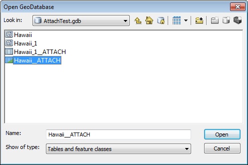

  1. Right-click the _1_ATTACH table, and click Load > Load Data.
  2. Click Next, and use the input data file browser to navigate to and select the original ATTACH table. Click Open and Add.
Image showing the ATTACH table
