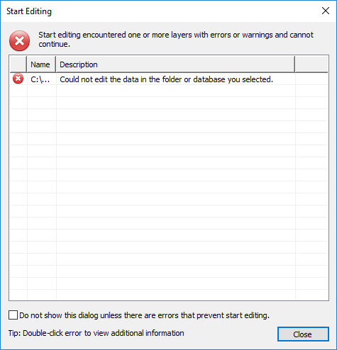

When attempting to edit a layer containing an annotation feature in ArcMap, the following warning message is returned:
Warning:
Could not edit the data in the folder or database you selected.
Image of warning message
Cause
