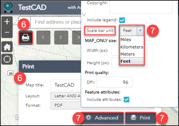

  6. Click the Print button on the map, fill in the title for the map in the Map title text box and select the applicable Layout and Format for the exported map.
  7. Click the Advanced button and navigate to Scale bar unit under Layout metadata to select the desired scale unit. Edit other settings if required and click Print. Refer to ArcGIS Web AppBuilder: Print widget for more information.
The Print widget configuration window in ArcGIS Web AppBuilder.
