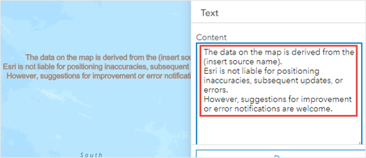

The disclaimer text is added in the Content box in the Text pane as a text feature.
The image below shows the disclaimer displayed as a text feature in ArcGIS Online Map Viewer.
The disclaimer displayed as a text feature in the web map in ArcGIS Online Map Viewer.

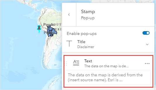

  3. In Map Viewer, add a stamp feature to the web map, configure the pop-up for it, and add the disclaimer text in the pop-up. Refer to ArcGIS Online: Add stamps for more information.
The disclaimer text is added as a pop-up under Text in the Stamp pane.

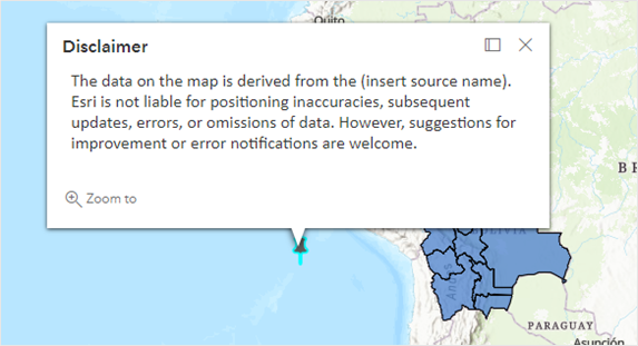

The image below shows the stamp pop-up disclaimer displayed in ArcGIS Online Map Viewer.
The disclaimer text displayed as the pop-up after clicked at the stamp feature in ArcGIS Online Map Viewer.
