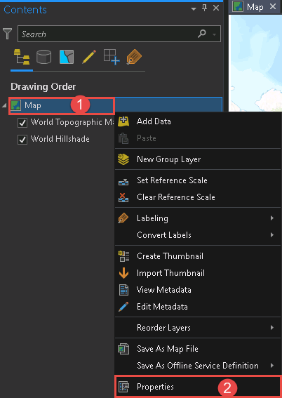

In ArcGIS Pro, change the transformation path of the map containing the layers to GDA 1994 To WGS 1984 before publishing the layers to Portal for ArcGIS.
  1. In ArcGIS Pro, in the Contents pane, right-click the map containing all the layers and click Properties.
The Contents pane with the map properties of the map

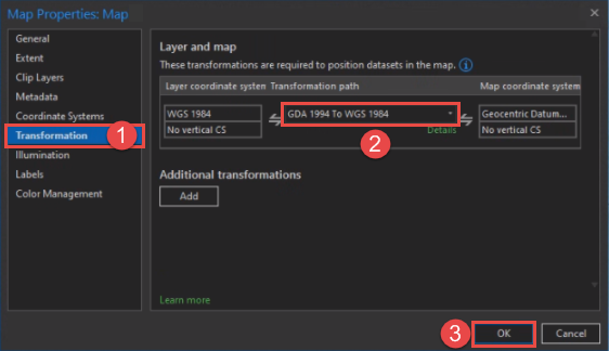

  1. In the Map Properties window, click Transformation.
  2. For Transformation path, click GDA 1994 To WGS 1984 from the drop-down menu.
  3. Click OK.
The Map Properties window with the GDA 1994 To WGS 1984 transformation path option
