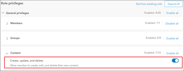

Update the member’s user type, default role, or custom role to enable the privilege to create content
Note:
Only an organization's administrator can perform the following workflows.
Image of the Role privileges window

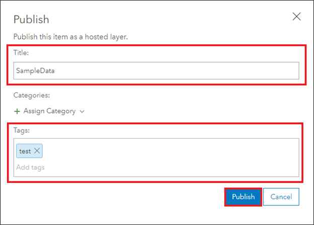

Publish the feature layer as a hosted feature layer in ArcGIS Online
  1. Sign in to ArcGIS Online. Click Content > My Content
  2. Browse to the feature layer, click More Options Image of the More Options button, and select View item details

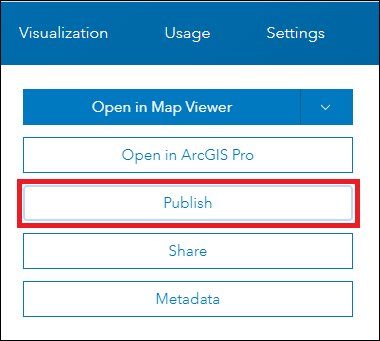

  3. On the item details page, click Publish.
Image of the Publish button
  1. In the Publish window, add your title and tags to the Title and Tags fields, and click Publish.
Image of the Publish window

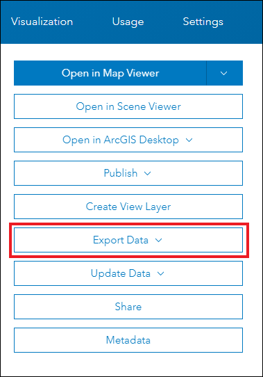

The image below shows the Export Data option is available on the web layer’s item details page.
Image of the Export Data button
