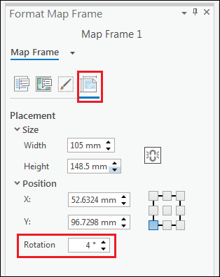

This option rotates only the map frame in the layout view, and not the map referenced by the map frame. To rotate the referenced map, follow the first method provided above.
Note: In the layout view, the map frame can be rotated manually by moving the rotation handle at the corner of the map frame.
