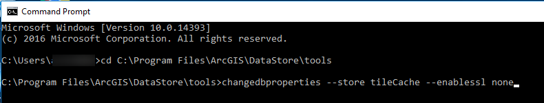

Alternatively, if enabling SSL 3.0 is not an option, run the 'changedbproperties' command with the 'enablessl' parameter set to 'none'.
cd C:\Program Files\ArcGIS\DataStore\tools
changedbproperties --store tileCache --enablessl none
