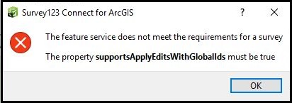

In ArcGIS Survey123 Connect, when attempting to create a survey from an existing feature service in ArcGIS Online or Portal for ArcGIS, the following error message is returned:
Error:
The feature service does not meet the requirements for a survey
The property supportsApplyEditsWithGlobalIds must be true
The error when attempting to create a survey from an existing feature service in ArcGIS Online or Portal for ArcGIS

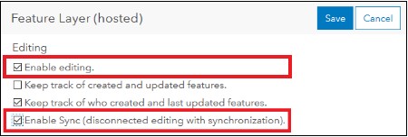

Enable the sync capability of the feature service
  1. In ArcGIS Online or Portal for ArcGIS, navigate to Content > My Content > Folders and browse to the hosted feature layer.
  2. Click the Options button Options button, and click View item details. In the item details page, click the Settings tab.
  3. Under the Feature Layer (hosted) settings, in the Editing section, check the Enable editing and Enable Sync (disconnected editing with synchronization) check boxes.
  4. Click Save and proceed to create the survey in ArcGIS Survey123 Connect.
The Feature layer (hosted) setting.
