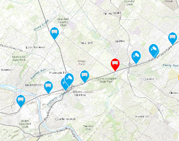

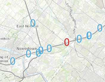

The following images demonstrate how the custom font is displayed between ArcMap and Portal for ArcGIS.
ArcMap
The custom symbol font displays correctly in ArcMap.
Hosted feature service in Portal for ArcGIS
The custom symbol font incorrectly displays in Portal for ArcGIS.
