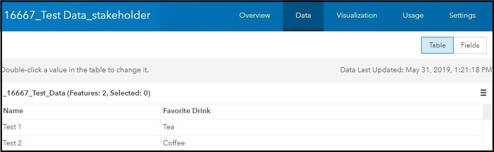

The image below shows the updated survey form and results are not updated in the results view in ArcGIS Online or Portal for ArcGIS.
Old Stakeholder View in ArcGIS Online.

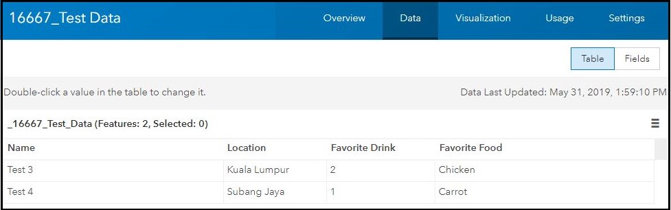

The image of the republished feature service below shows the updated feature service in ArcGIS Online or Portal for ArcGIS.
Updated feature service in ArcGIS Online.

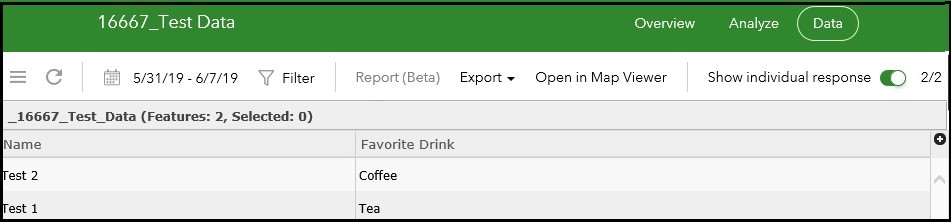

The image below shows the survey results are not updated in the user account in ArcGIS Survey123.
User account view in Survey123 for ArcGIS.

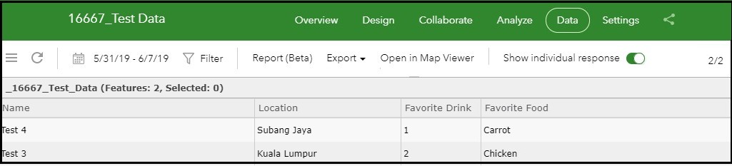

The image below shows the survey results are updated in the publisher account in ArcGIS Survey123.
Publisher account view in Survey123 for ArcGIS.
