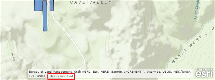

The copyright text of a hosted feature service is dictated by the text entered in the credits section of the feature layer properties in the original map document. When the feature layer is published to ArcGIS Online and added to a web map, the copyright text of the hosted feature service is displayed in the lower right corner of a web map, next to the copyright attribution of the basemap used in the web map.
User-added image
The copyright text can be modified in the original map document of the feature layer or through the Admin view of the REST endpoint of the feature service.

  6. Find the line for "copyrightText", and append the new copyright text, for example: "copyrightText" : "This is modified" ,
    The text added here is displaed as the copyright attribution in web maps the feature service is added to.
