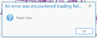

In ArcGIS Pro, when trying to open fields view the following error message is presented:
"An error was encountered loading fields view".
  • This occurs on all datasets, and the fields view cannot be opened for any data.
  • A clean uninstall and clearing of registry keys does not resolve the issue.

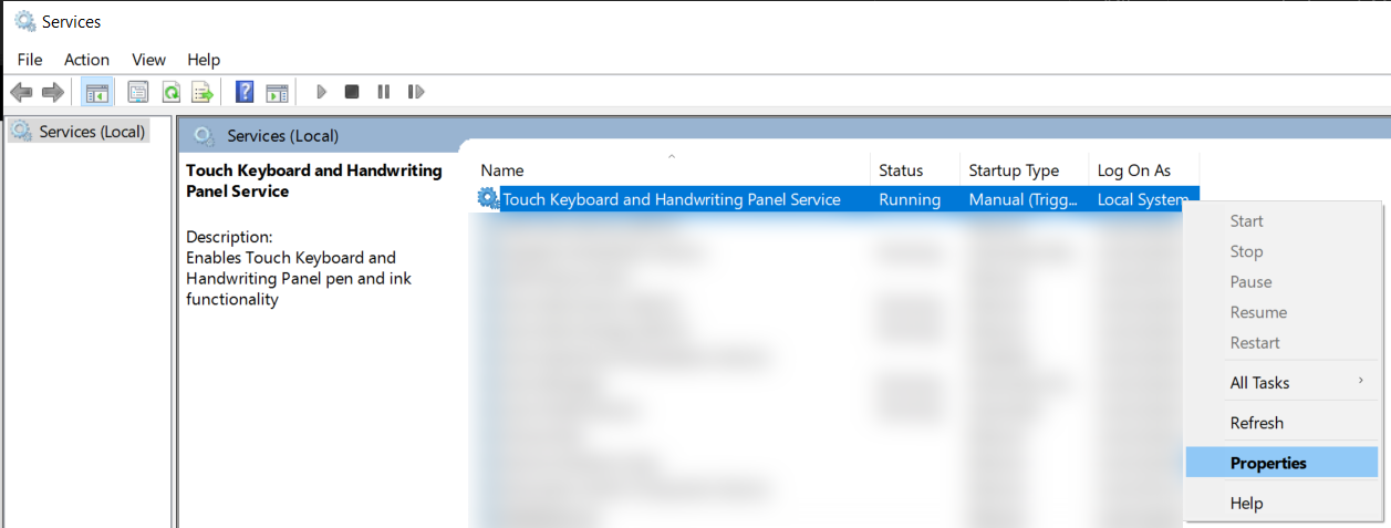

Check the system Services console to ensure that the Touch Keyboard and Handwriting Panel Service is enabled:
  1. From the Start menu, open the Windows Services app.
  1. Locate the Touch Keyboard and Handwriting Panel Service, and right-click to open the Properties dialog, as shown in the next image.
Touch Keyboard and Handwriting Panel Service properties

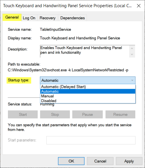

  1. Switch to the General tab.
  2. Click the drop-down button next to Startup type.
  3. Change it to the Automatic type, as shown in the next image.
Startup type automatic
  1. Click Apply and restart the computer.
