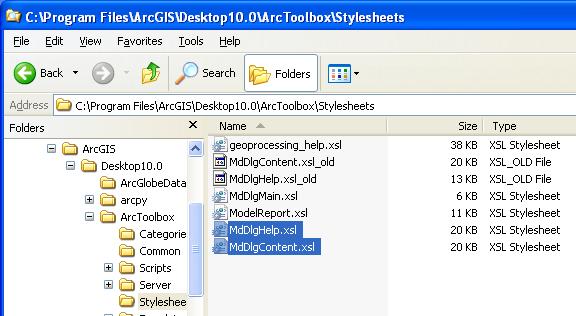

- In Windows Explorer, navigate to the Stylesheets folder in the ArcGIS installation folder. This is usually located at:
C:\Program Files\ArcGIS\ArcToolbox\Stylesheets
- In the Stylesheets folder, rename MdDlgContent.xsl to MdDlgContent.xsl_old and rename MdDlgHelp.xsl to MdDlgHelp.xsl_old.
- Copy the two new files that were extracted from the ZIP file to the Stylesheets folder. The contents of the folder should look like the screen shot below.
The geoprocessing tools open without error.
C:\Program Files\ArcGIS\Desktop10.0\ArcToolbox\Stylesheets
