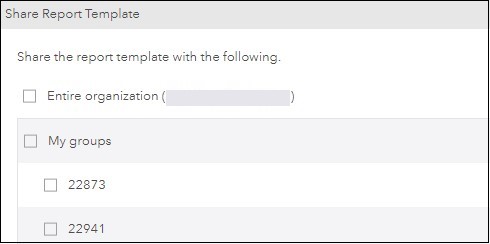

  1. Share the infographics template to the entire organization or a desired group in the organization.
    1. Log in to ArcGIS Business Analyst Web App, and open the desired project.
    2. Click the Reports tab. Click Build Infographics.
    3. Click My templates. Hover over the desired infographic template, and click the Share template icon Share template..
    4. In the Share Report Template window, select Entire organization (organization_name) or a desired group under My groups, and click Share.
Share template.
