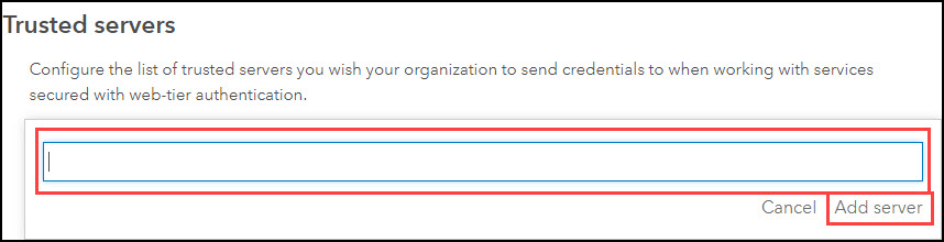

  2. Under Trusted servers, click Add trusted servers.
  3. In the text dialog box, specify the server URL containing the domain, and click Add server. Refer to ArcGIS Online: Trusted servers for more information regarding the URL format.
The text dialog box of the Add trusted server option
