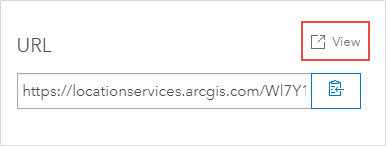

  4. On the item details page, scroll down to the bottom of the page. In the URL section, click View.
The View button in the URL section.

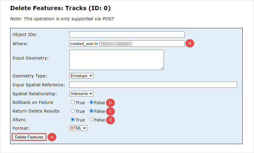

  1. On the Delete Features: Tracks (ID: 0) page, configure the Delete Features operation.
    1. For Where, type created_user in ('<username>').
Note:
For more information on the clauses used in this workflow, refer to ArcGIS Online: Deleting tracks.
  1. For Rollback on Failure, click False.
  2. For Return Delete Results, click False.
  3. For ASync, click True.
  4. Click Delete Features.
The Delete Features parameters configured on the Delete Features page.

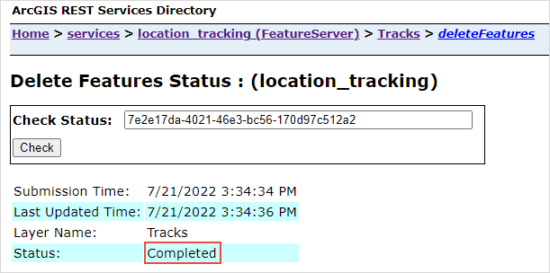

  1. Click the link in statusURL.
The link for statusURL.
When 'Completed' is returned in Status, the tracks are deleted from the location sharing layer.
The Completed message displayed for Status in the Delete Features Status page.
