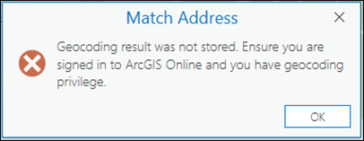

In ArcGIS Pro, when attempting to rematch addresses using the ArcGIS World Geocoding Service locator, the following error message is returned:
Error:
Geocoding result was not stored. Ensure you are signed in to ArcGIS Online and you have geocoding privilege.
The geocoding process is unsuccessful and an error message is returned in ArcGIS Pro.

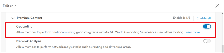

Update the member’s role to enable the privilege to perform geocoding tasks
Update the member’s custom role to enable the Geocoding option in the Premium Content settings. Refer to ArcGIS Online: Configure member roles for more information.
Configure the custom role to enable the geocoding privilege.

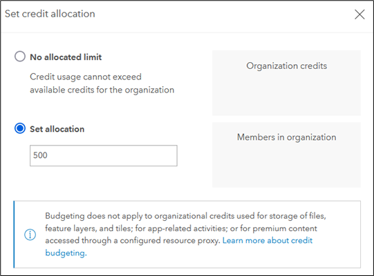

Allocate credits to the member to perform credit-consuming geocoding tasks in ArcGIS Pro
Note:
Ensure the organization has sufficient credits to allocate credits to members. In ArcGIS Online, navigate to Organization > Overview to check credits status. Refer to ArcGIS Online: Get more credits for more information.
In ArcGIS Online, allocate credits to the member to perform credit-consuming geocoding tasks in ArcGIS Pro. Refer to ArcGIS Online: Manage credit budget for more information.
Administrators can allocate a credit budget that assigns a flexible allocation of credits to some or all organization members.
