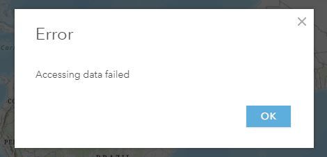

When a new ArcGIS Survey123 feature service is created, the data is not visible in the ArcGIS Online Map Viewer. When trying to view the data in the Attribute table, the following error is returned:
Error: Accessing data failed

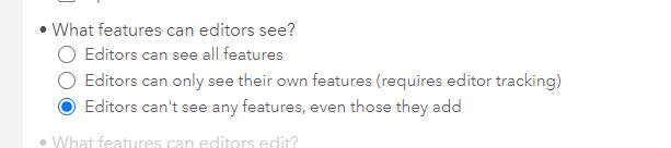

The consequence is the setting under 'What features can editors see?' is set to 'Editors can't see any features, even those they add' by default, as shown in the image below.

Modify the setting under the What features can editors see? section as required.
