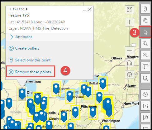

  1. Use the Select tool to select the points to be deleted. A pop-up menu is displayed.
  2. Click Remove these points from the pop-up menu as shown in the image below.
The selected points can be removed

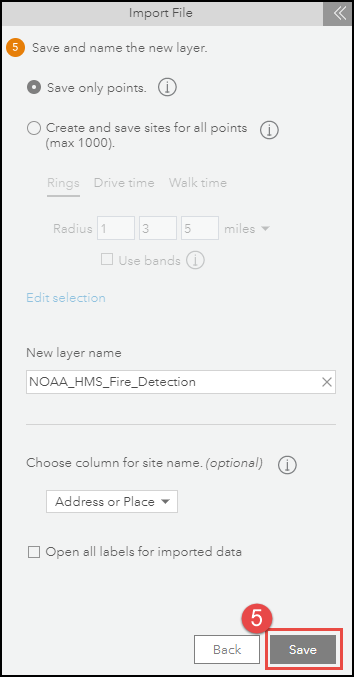

  1. Click Save.
Click the Save button to save the layer
