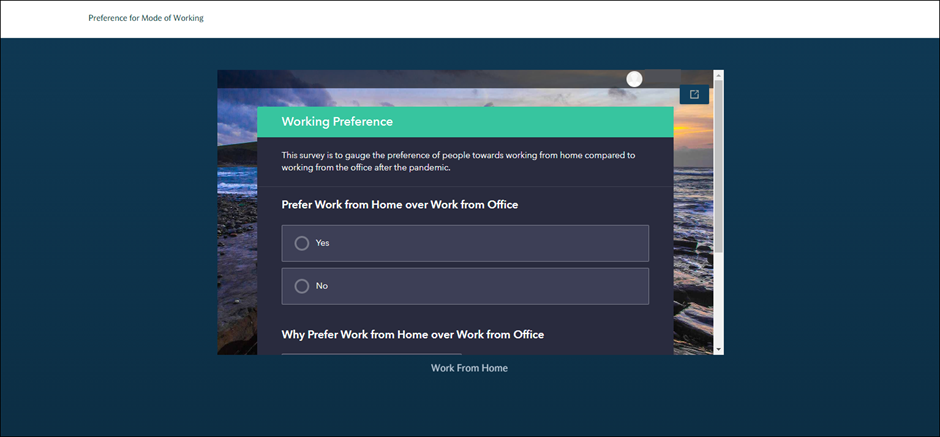

The image below shows a survey embedded in a story using the iframe code.
Embedded survey with header, footer and theme
