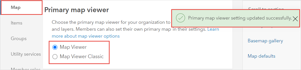

  2. Click Organization > Settings.
  3. On the left side of the Settings page, select the Map tab.
  4. In the Primary map viewer section, select the primary viewer for the organization.
The message pops up after successfully updating the primary map viewer for the organization in ArcGIS Online.

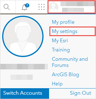

  2. On the top-right corner of the web page, click the user profile, and click My settings.
My settings option displayed after clicking the user profile.

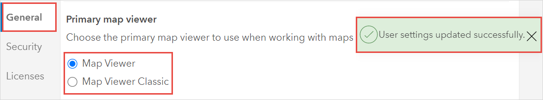

  1. On the left side of the My settings page, click the General tab.
  2. In the Primary map viewer section, select the primary map viewer for personal use.
The message pops up after successfully updating the primary map viewer for personal use in ArcGIS Online.
