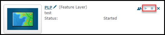

ArcGIS Server Manager allows managing, tuning, and organizing services for ArcGIS Enterprise organizations. However, the Start and Stop buttons are unavailable for hosted feature services in ArcGIS Server Manager, as shown in the image below.
By design, the Start and Stop buttons are unavailable when managing the hosted feature services in ArcGIS Server Manager as the services are stored in ArcGIS Data Store. The Start and Stop buttons are only available for non-hosted services.

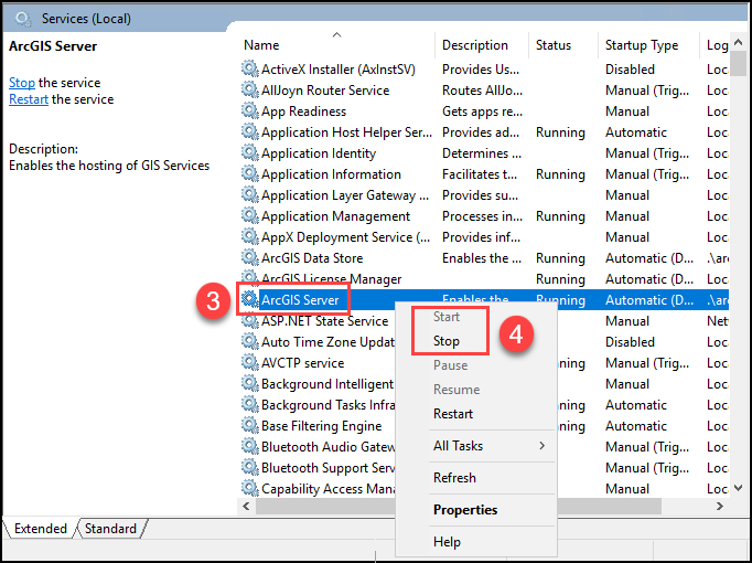

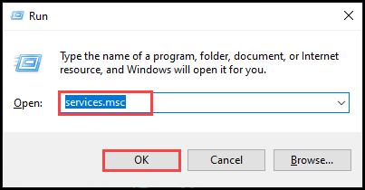

Use the Services.msc command to start and stop the ArcGIS Server service
Note: The following procedure stops all services available in ArcGIS Server. Ensure there are no processes in operation by all users available within the organization before proceeding.
On the ArcGIS Server machine, use the Services.msc command to start and stop the ArcGIS Server service via the Services window. This also starts and stops the hosted feature services in ArcGIS Server.
