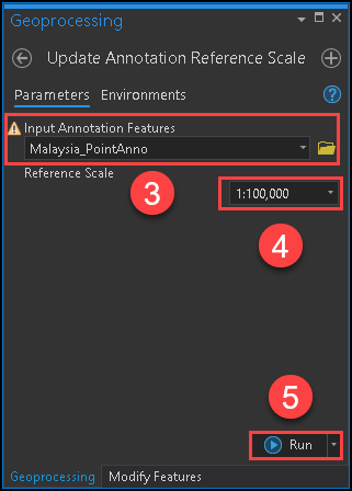

Use the Update Annotation Reference Scale tool
In ArcGIS Pro, use the Update Annotation Reference Scale tool to change the reference scale of all existing annotations in the layer to a different value.
- In ArcGIS Pro, navigate to the Analysis tab and click Tools.
- In the Geoprocessing pane, search for and select the Update Annotation Reference Scale (Cartography) tool via the Find Tools search box.
- In the Update Annotation Reference Scale pane, select the annotation layer from the Input Annotation Features drop-down list.
- Specify a reference scale in the Reference Scale parameter.
- Click Run.
