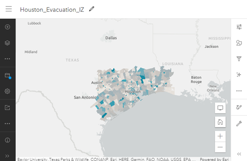

The image below shows the clipped basemap displaying a specific area of Houston in Map Viewer.
