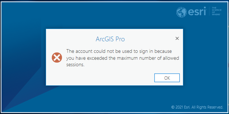

When attempting to log in to ArcGIS Pro with an ArcGIS Online account, the following error message is returned:
Error:
The account could not be used to sign in because you have exceeded the maximum number of allowed sessions.
Logging in to ArcGIS Pro fails and an error message is returned.
Cause
The ArcGIS Online account has been used to log in to ArcGIS Pro on three different machines at the same time, and the maximum number of allowed active ArcGIS Pro sessions is three.

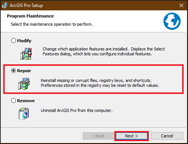

If the methods described above fail, run the repair on ArcGIS Pro.
  1. On the machine wherein ArcGIS Pro is installed, navigate to Control Panel > Programs > Programs and Features.
  2. Browse to and right-click ArcGIS Pro. Select Change.
  3. Click Yes when prompted, and click Repair > Next.
Run the ArcGIS Pro installer to repair it.
  1. Click Install. Once the repair is complete, click Finish.
