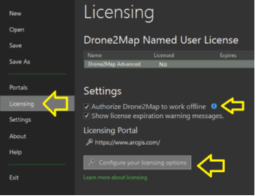

- In Drone2Map v2022.1, click the Project tab and select Portals > Add Portal.
- Add the portal URL for the 10.9.1 standalone version of Enterprise.
- Select Licensing and enable the checkbox for Authorize Drone2Map to work offline, and click Configure your licensing options.
- In the popup, select your 10.9.1 standalone version of Enterprise
These instructions enable user(s) to connect one time to Enterprise 10.9.1 to license Drone2Map, and then if the license is “offline”, the 10.9.1 Enterprise may be shut down. The offline license will remain valid until the annual expiration date.
