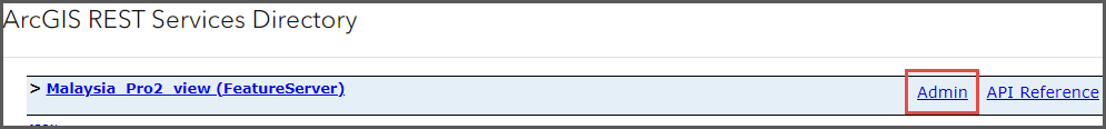

  3. Click View The View button.png to open the layer's REST endpoint window.
  4. In the ArcGIS REST Services Directory window, click Admin.
Image of ArcGIS REST Services Directory Admin link

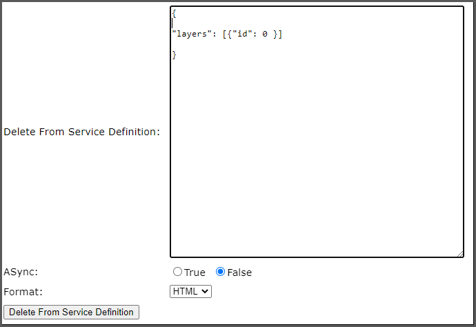

  1. In the ArcGIS REST Services Directory window, scroll down and click Delete From Definition.
  2. Under ArcGIS REST Services Directory, replace the code in the Delete From Service Definition text box with the following code:
"layers": [{"id": 0 }]
The code replacement
  1. Click Delete From Service Definition to save and return to the previous page.

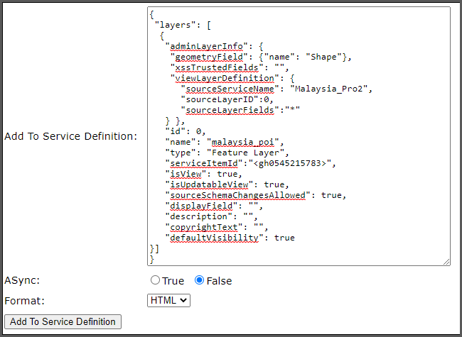

  2. In the ArcGIS REST Services Directory window, scroll down and click Add To Definition.
  3. Under ArcGIS REST Services Directory, replace the code in the Add To Service Definition text box with the following code:
 "layers": [
   "adminLayerInfo": {
    "geometryField": {"name": "Shape"},
    "xssTrustedFields": "",
    "viewLayerDefinition": {
      "sourceServiceName": "<name_of_service>",
      "sourceLayerID":0,
      "sourceLayerFields":"*"
   "id": 0,
   "name": "<name_of_layer>",
   "type": "Feature Layer",
   "serviceItemId":"<item_ID>",
   "isView": true,
   "isUpdatableView": true,
   "sourceSchemaChangesAllowed": true,
   "displayField": "",
   "description": "",
   "copyrightText": "",
   "defaultVisibility": true
  1. Click Add To Service Definition to save.
