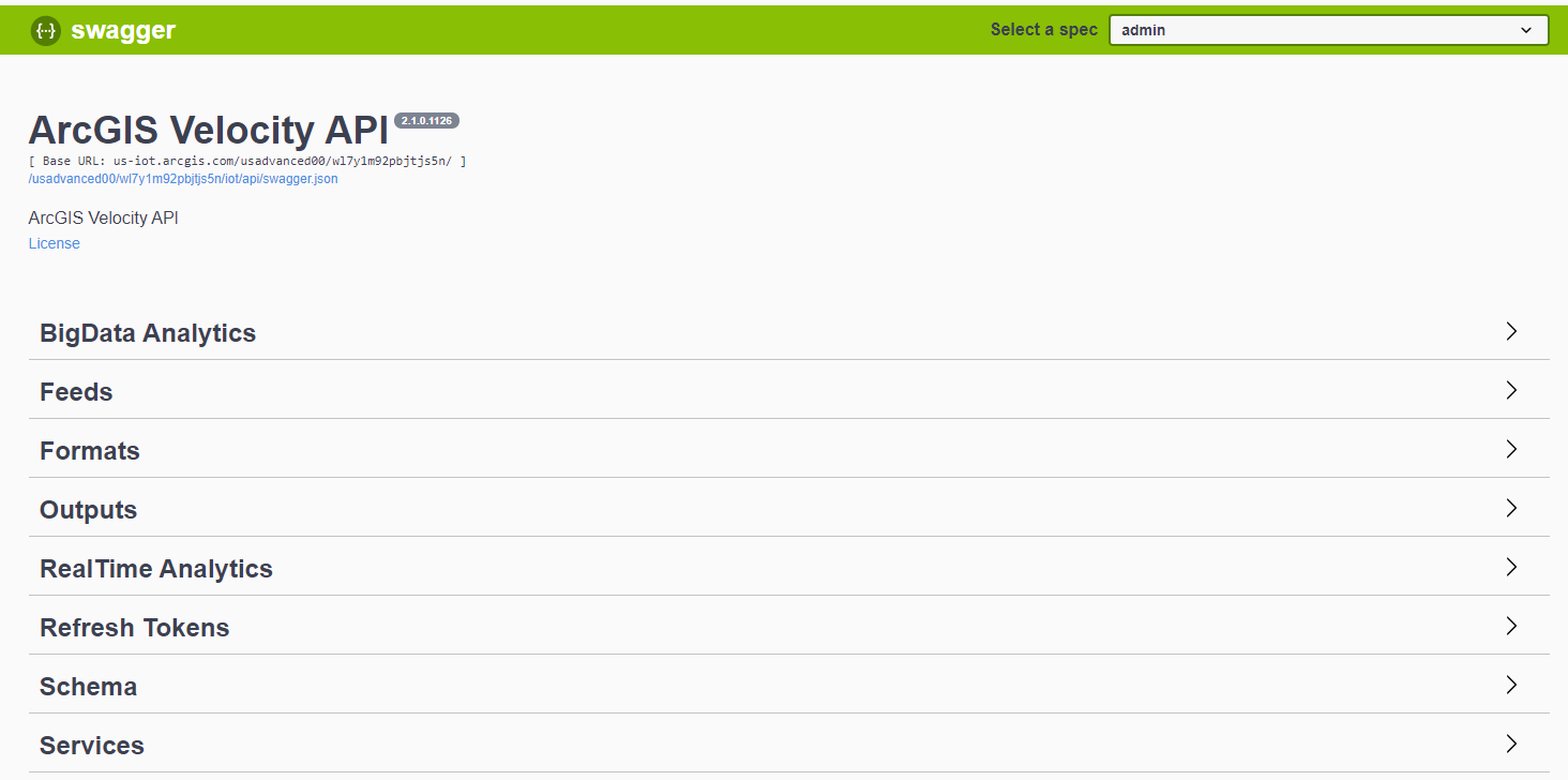

The Swagger interface is shown in the image below.
Swagger user interface

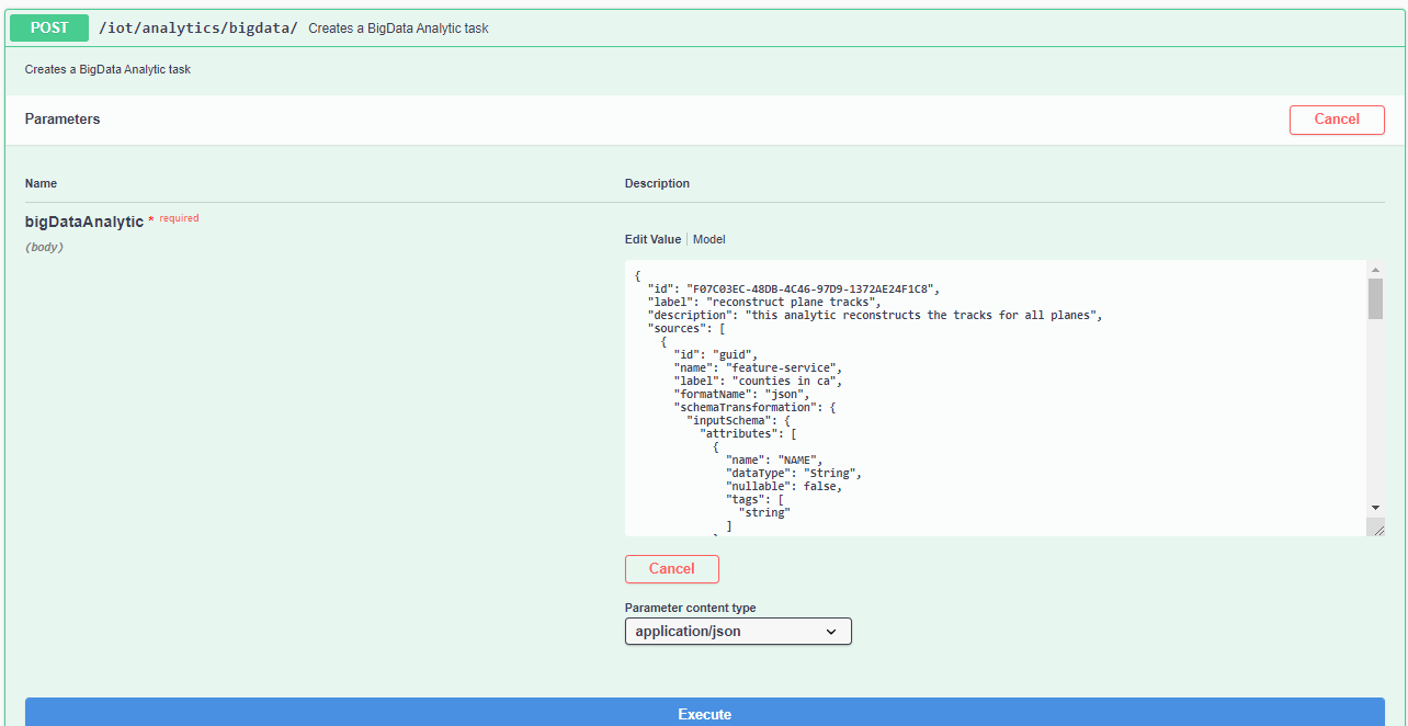

Through the tabs in this interface, you can get the JSON definition of feeds, outputs, and analytics, as well as create new items through POST requests. This is especially useful for making copies of Real-Time Analytics or Data Feeds, and even works between ArcGIS Online organizations.
Swagger POST request
