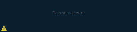

When transitioning to ArcGIS Dashboards, custom widgets created in ArcGIS Dashboards Classic do not function as expected. The widgets load indefinitely when viewed in ArcGIS Dashboards, and the following error returns:
Error:
Data source error
Data source error displayed on widgets
