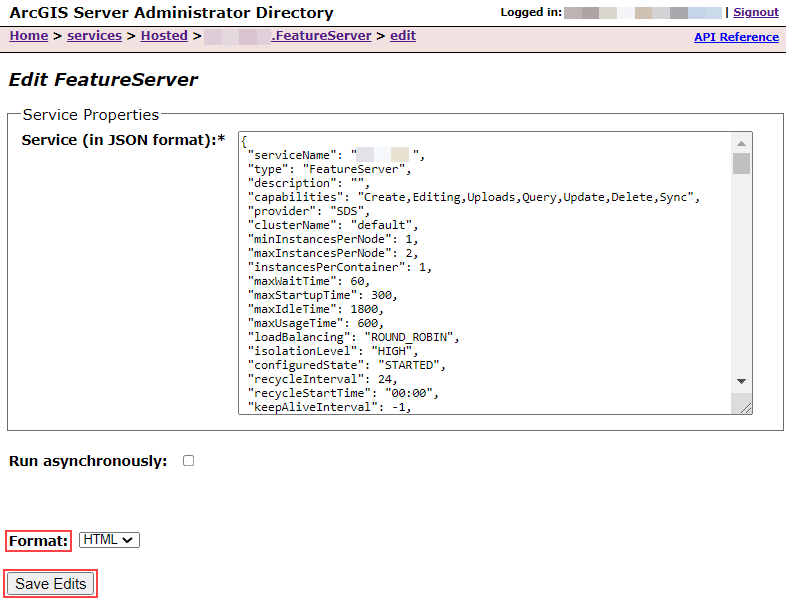

- In the Service page, for Supported Operations:, click edit. This option can be found at the bottom of the page.
- In the Edit FeatureServer page, locate the parameters and make the necessary edits.
- Specify a format from the Format: drop-down menu.
- Click Save Edits.
