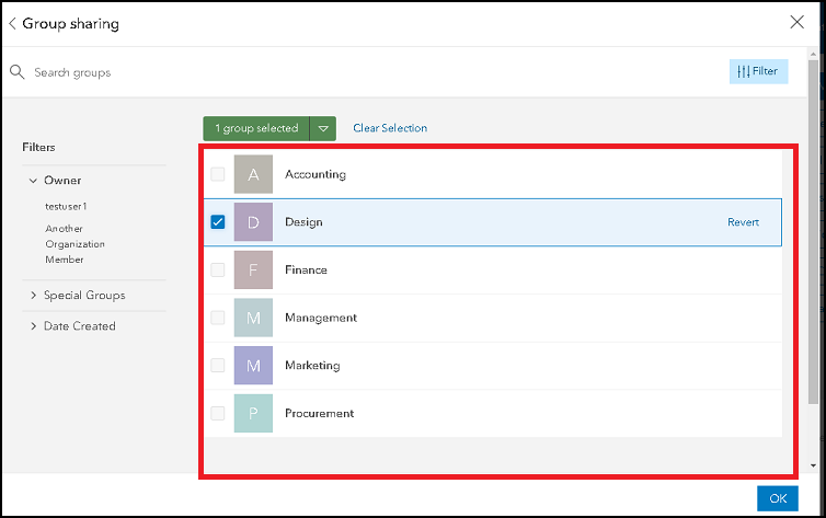

In Portal for ArcGIS, users with sufficient privileges can share public and organizational content. In some instances, a group is not displayed as an option when attempting to share organizational content. The image below demonstrates the HR group is not displayed as an option in the Group sharing window.
The Group sharing window displaying the groups available to share the content with.
Cause
  • The user is not a member of the group.
  • The group settings are configured to only allow group owners and managers to contribute content.

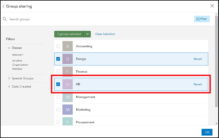

Add the user as a member of the group
If the user does not belong to the group, add the user to the group. Refer to Portal for ArcGIS: Assign members to groups for the steps to do so.

The image below shows the HR group is displayed in the Group sharing window after the user is added to the HR group.
The Group sharing window showing the HR group is displayed.
